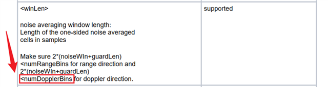

Hello E2E Experts,
Good day.
As shown in the following figure, I see numDopplerBins in the cfarCfg configuration of DDM. May I ask if numDopplerBins is equal to numAdcSamples?
And where is numDopplerBins configured?
TICSC
    Number of doppler bins configured is equal to the total number of chirps. And number of range bins is equal to number of ADC samples/ 2 in case of AWR2944 since the ADC samples are real only.
    frameCfg 0 5 128 0 384 50 1 0
    In the above configuration, number of unique chirps is 6 and number of chirps loops is 128. So, total number of chirps will be 6*128 = 768 -> number of doppler bins.
