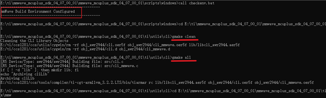

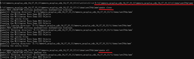

  • Hi Gabriel,
    I operated according to Method B of the Hard Coded Config User Guide. The intermediate process and result are shown in Figure 1 below. Then I jumped to E:\ti\mmwave_mcuplus_sdk_04_07_00_01\mmwave_mcuplus_sdk_04_07_00_01\ti\demo\awr294x\mmw to rebuild the OOB project. The intermediate process is shown in Figure 2 below. I downloaded the newly generated appiamge file to the AWR2944EVM, but the HCC function was not implemented. May I ask where I went wrong during my operation?
    Several questions
    Where is hard coded config use guide you have mentioned?
    Also can you provide the error you receive as well?
    I wan to run this on my end and see if I can recreate.
    Gabriel
  • Also there is a section at the following location called "How to bypass CLI" that has more info regarding hardcoding the config. Also the HECR demo is an example of this being done
    Millimeter Wave (mmw) Demo for AWR294X
    file:///C:/ti/mmwave_mcuplus_sdk_04_07_01_03/mmwave_mcuplus_sdk_04_07_01_03/ti/demo/awr294x/mmw/docs/doxygen/html/index.html
    Gabriel
