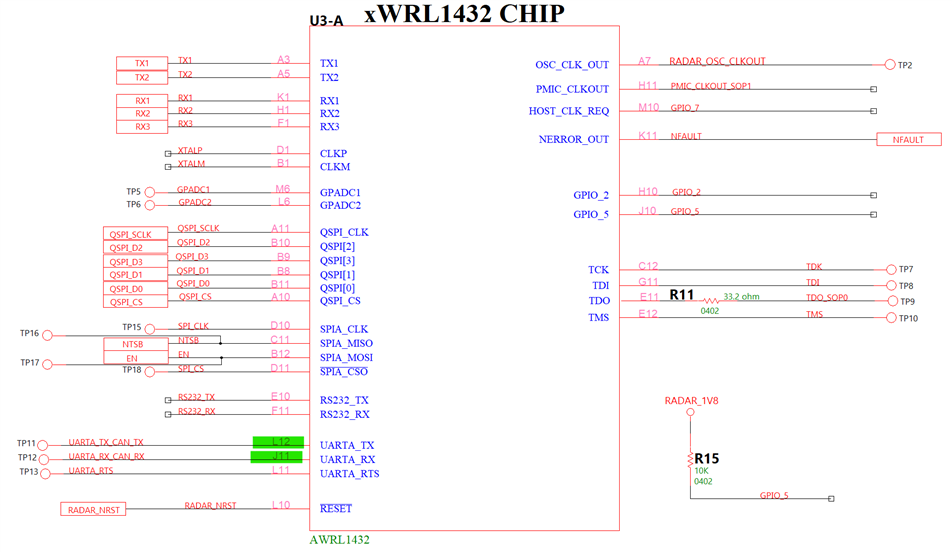

Hi TI,
For the AWRL1432, could you please confirm if the L12 and J11 pins, when configured as UART TX/RX or CAN TX/RX, require an external pull‑up to the supply voltage (e.g., 3.3 V or 1.8 V)?
JN
Hi TI,
JN
Hi JN,
10k ohm pull-up is required on L12 & J11 pins when it is configured as UART Tx/Rx.
