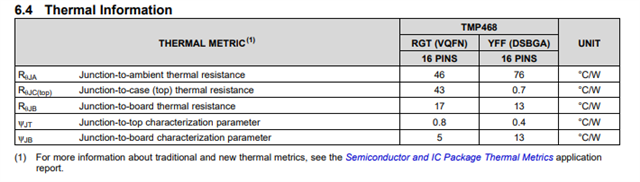

Please share the below thermal info of the the part TMP468AIRGTT.
RThetaJB

All thermal info related to TMP468 is on page 5 of the datasheet. For more information about traditional and new thermal metrics, see the Semiconductor and IC Package Thermal Metrics (Rev. D) application report.
