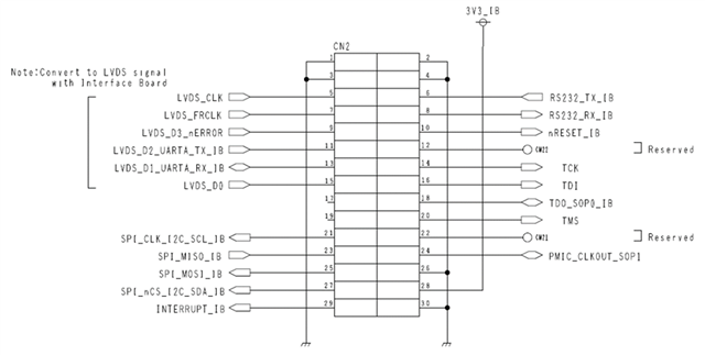

Q1: Is UART mandatory for controlling the IWRL6432AOP?
The User's Guide (swru596b) includes the following description: Application/user UART (Configuration and data communication to PC)
EVM uses a single UART port for both device configuration and processed data communication to PC.
Q2: SPI boot is supported ? HOST MCU(Flash MCU) to have AWRL6432's firmware.
Also, is the SOP setting "MODE2" appropriate?
