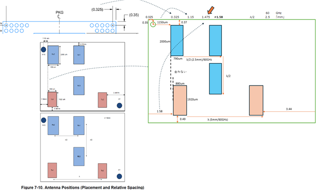

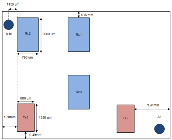

7.14 Antenna Positions Figure 7-10 shows the placement and relative spacing of the antennas
The distance dimension from the IC package edge to the antenna does not match. Can the dotted line indicating the positional relationship between RX2 and TX1 be ignored?
