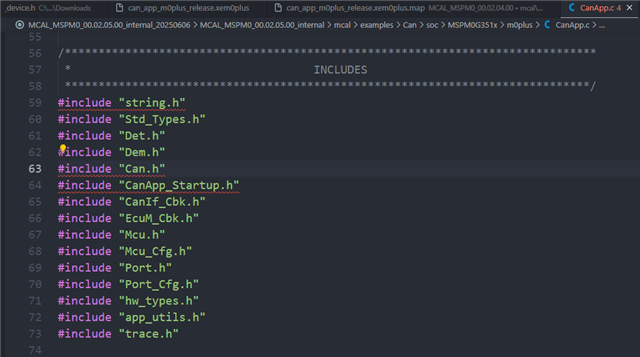

  • Hi Prashant,
    Thanks for your feedback and sorry for the late response.
    As for the compile error, I tested with the CanApp example in the MCAL package, but not find this error. As you said, the CAN_UNINIT and CAN_READY is defined in Can_GeneralTypes.h, which is further included in the can.h file. If you keep these header file as same, I think this macro undeclared error should not occur.
    Could you please share more information about your problem background? Thanks.
    Pengfei
  • Hi Pengfei
    If we include Can_GeneralTypes.h, we get a lot of errors related to redefinition. Please check the error log below.

  • Hi Prashant,
    Sorry I may not state clearly. I did not let you to include the Can_GeneralTypes.h in your main program, actually this header file is included in Can.h file, and you could directly include Can.h in your main program.
    You could refer to CanApp.c example in path of \mcal\examples\Can\soc\MSPM0G351x\m0plus\CanApp.c.
    Pengfei
