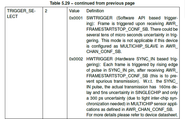

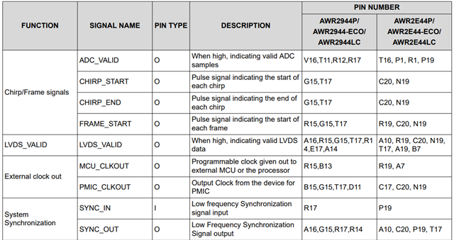

    We need hardware frame-start trigger synchronization, so we can start multiple AWR2944Ps at the same time with a digital pulse.
  • Hi Emil,
    Below is a screenshot from AWR2944P/AWR2E44P/AWR2944-ECO/AWR2E44-ECO/AWR2944LC/AWR2E44LC Single-Chip 76 to 81GHz FMCW Automotive Radar Sensor datasheet (Rev. A) regarding SYNC_IN pin -
    When you configure the frames, you can use Hardware SYNC_IN based triggering.
    You can check section Sub block 0x0102 – AWR_FRAME_CONF_SET_SB of "C:\ti\mmwave_mcuplus_sdk_04_07_01_03\mmwave_dfp_02_04_18_00\docs\mmWave-Radar-Interface-Control.pdf".
