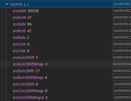

For test purposes I hardcode +- 60 degrees sector of azimuth and expect to get detections inside  27 ... 47 0 1 ... 21 indeces range (exclude bins 22 - 26) fornumAzimFFTBins = 48.
I get the following Input Formatter/Source config:
And I expect to catch all detections in unit test of DPU because there are no azimuth indexes outside this sector.
But as result I have miss detections in DPU's unit test app. In some test there are no detections at all.

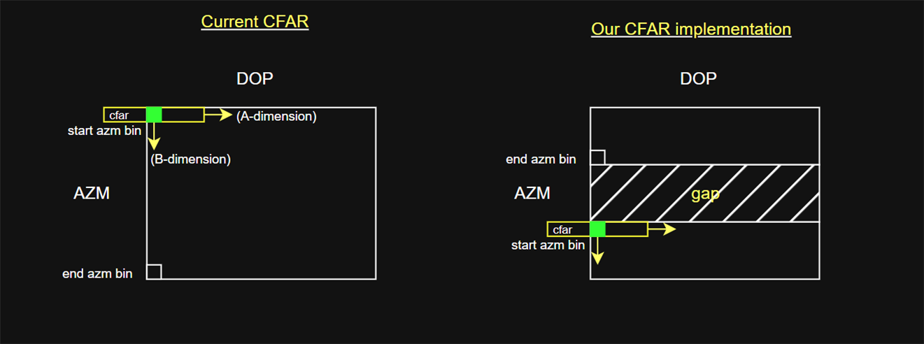

    I'm trying to implement CFAR scaning inside the specified field of view.
    Input formatter allow to add gap in middle of azimuth (B-dimension) if we start with offset and use wrap.
    But something wrong with my formatter configuration because CFAR misses objects that are located inside the specified sector (at Doppler Proc DPU Test).

    I have performed several experiments and found that even I configure srcBcircShift the output detections of CFAR is always have range from zero to srcBcnt.
    I mean that addressing in azimuth-doppler matrix performed as It has been configured but output azimuth indeces have no offset.
    Adding extra offset equal to configured srcBcircShift to azimuth bin indeces fix problem and I can see detections in right angle sector.
    Can you confirm that output of CFAR doesn't take in account srcBcircShift bin offset and counts indeces from zero?

  • Hi Dmitry,
    Input formatter is responsible to reformat the data before sending it to the compute engine. Once the data is passed from Input formatter to Compute Engine, input formatter registers configuration are not used anymore.
    Yes, you are correct.
