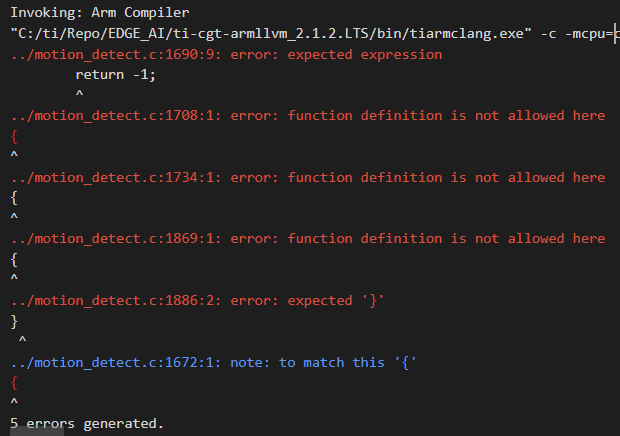

There is currently a typo in the Surface Classification project that is imported into Code Composer Studio, used for the integration and live preview features of Model Composer. This typo prevents compilation due to a syntax error, and must be fixed for the project to compile properly.
This is due to motion_detect.c found within surface_classification_demo_edgeai_xwrL64xx-GRASS-NOT. The fix can be done as follows
Before:
// Line 1688
CLI_write ("Error: mmWave Open failed [Error code: %d Subsystem: %d]\n",
                // mmWaveErrorCode, subsysErrorCode);
return -1;
// Line 1719
CLI_write ("Error: mmWave Config failed [Error code: %d Subsystem: %d]\n",
goto exit;
After:
// Line 1688
CLI_write ("Error: mmWave Open failed [Error code: %d Subsystem: %d]\n", mmWaveErrorCode, subsysErrorCode);
return -1;
// Line 1719
CLI_write ("Error: mmWave Config failed [Error code: %d Subsystem: %d]\n", mmWaveErrorCode, subsysErrorCode);
goto exit;
