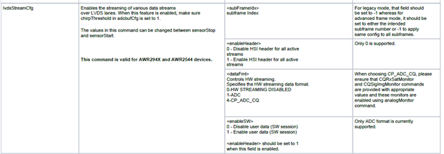

    I understand that in this alternative method I wouldn't use mmWaveStuio at all. Rather I would flash the AWR from CCS and pass to it a .cfg file and the DCA1000 would then capture and stream to my PC the raw ADC data.
    LVDS Streaming should be enabled using lvdsStreamCfg CLI command.
    lvdsStreamCfg -1 0 1 0 (to enable streaming of ADC data)

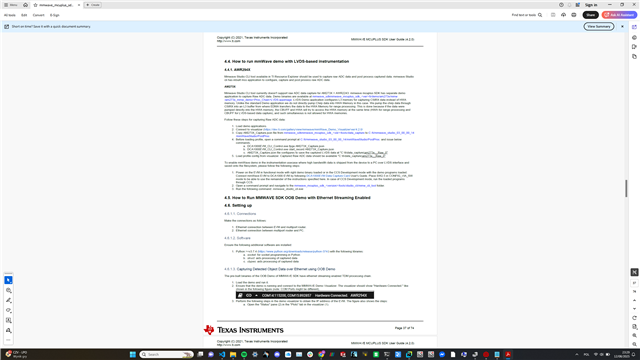

    thank you for your reply! Could you please clarify where I could read the documentation on running the demo from within CCS with LVDS? I found this in the mcu+sdk user guide but it is very vague (only the section for AM273X is a bit more precise):
    Also, just to confirm my understanding: if I enable LVDS streaming with the CLI command, I do not need to configure anything in mmWave Studio, correct? My assumption is that I can flash the demo from CCS in debug mode, run it by passing a .cfg file, and capture the raw data during operation with the DCA. Is that correct?

    You can enable LVDS streaming through the CLI (Mentioned in previous reply).
    To capture the ADC data using DCA1000,
    1. Use DCA1000EVM_CLI_Control.exe present in C:\ti\mmwave_studio_03_01_01_00\mmWaveStudio\PostProc to record the data in a *.bin file.
    2. Execute the following commands in the given sequence:
      1. fpga (for connection and configuration of DCA1000 with the PC)
        • DCA1000EVM_CLI_Control.exe fpga cf.json
      2. record (for providing information on packet delay)
        • DCA1000EVM_CLI_Control.exe record cf.json
      3. start_record (for starting the data capture)
        • DCA1000EVM_CLI_Control.exe start_record cf.json
    Refer to "C:\ti\mmwave_studio_03_01_01_00\mmWaveStudio\ReferenceCode\DCA1000\Docs\TI_DCA1000EVM_CLI_Software_UserGuide.pdf" and "C:\ti\mmwave_studio_03_01_01_00\mmWaveStudio\ReferenceCode\DCA1000\Docs\TI_DCA1000EVM_CLI_Software_DeveloperGuide.pdf" documents for more information regarding DCA1000EVM_CLI_Control.exe.
    Yes, you are correct.
