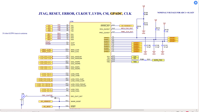

1、what's mean of 1V8,1V2,1V0?

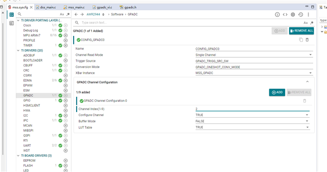

2、I use single channel gpadc mode to get value of GPADC2,the avgvalue is always 679,what's mean of 679,how can I convert the value '679' to real voltage?
    The 1.2V, 1.8V, and 1.0V are the supply voltages from the PMIC which are being monitored by GPADC1,2,3.
    To convert to voltage you would compute the same as any other ADC.
    V = (ADCcode * ADCref)/(2^bits) = (679*1.8)/(2^10) = 1.19V.\
