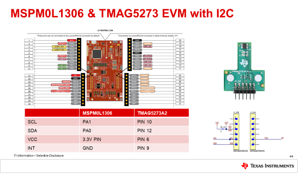

My customer is evaluating TMAG5273 to use the temperature sensor by LP-MSPM0L1306.
Here is the register configuration sent from MCU to TMAG5273EVM.
  • DEVICE_CONFIG_1: 0x00(register address) → 0x01h (settings value)
    I2C_RD to select read mode to 1-Byte I2C Read Command for 16-Bit Data With CRC Disabled, CRC_EN = 0b
  • DEVICE_CONFIG_2: 0x01(register address) → 0x02h (settings value)
    Change operation mode to continuous measure mode
  • T_CONFIG: 0x07h(register address) (T_CH_EN) → 0x01h (settings value)
    Enable the temperature sensor
After reading the data from Register Address of Temperature Sensor – Total of 16bit data, the results sent to the mcu register is as following.
  • Results : 0x32", "0x50", "0x00"
    I think these result shows the T_MSB as 0x32 and T_LSB = 0x50 and CONV_STATUS = 0x00.
    After i convert the results using following formula. The results says that -50℃ but the temperature room we evaluated is 25℃.
Could you please check the following code and look any mistaken code there ?

  • Hi Kenley,
    Thank you for posting to the Sensors forum!
    What do you have MAG_CH_EN set to in SENSOR_CONFIG_1?
    Are you able to share a capture from a logic analyzer of the full data read back from the microcontroller?
    ~Alicia
  • Hi Alicia
    Thank you for the support.
    We do not set for MAG_CH_EN, is it recommended to send configuration data even though we do not use it ?
    regards,
    Kenley
  • Hi Kenley,
    MAG_CH_EN should not have to be set, I was just asking in case it was.
    Using the same settings that you are with an analog discovery 2 kit, I was able to successfully read back the temperature data, so I am not sure why it doesn't seem to be working for you.
    Just in case, can you try enabling MAG_CH_EN to see if that helps? Alternatively, if possible, could you try testing this out with the GUI (Note: to do this you will need the TI-SCB) to see if you are getting the same results?
    ~Alicia
