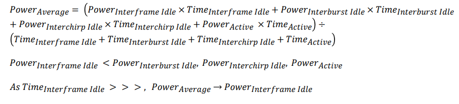

I have some confusion regarding how the mmWaveSensingEstimator version 2.5.0 calculates average power. I am attaching a picture for reference. As can be seen that the tool estimates the power to be 117.715 mW. While using the time and power settings if I calculate them my selves as follows:
Mode Time (us) Power (mW) Energry = Power x Time
Active Mode 6912 802.790 5548884.48
Interburst Idle 0 802.790 0
Processing 10000 77 770000
Interframe Idle 93088 0.660 54838.08
Total 100000 NA 6373722.56
Average Power =  Total Energy / Total Time = 6,373,722.56 / 100,000 = 63.74 mW
The mmWaveSensingEstimator version 2.5.0 tool calculates the power as 117.71 mW. My questions are as follows:
  1.  What is causing the discrepancy in two power calculations (i.e. one done manually and the other by the tool)?
  2.  How is idle time classified. Is it classified under active mode, interburst idle or interframe idle?
  3.  What is the interburst idle power consumption?
  4.  Is there documentation that I can refer too regarding the inner working of the mmWaveSensingEstimator version 2.5.0?
Thanks for your help in this regard.

    First and foremost, I would highly recommend reviewing the xWRL6432 Power App Note which includes a simplified equation for calculating the average power.
    If you could share your configuration, I can double check the calculations here.

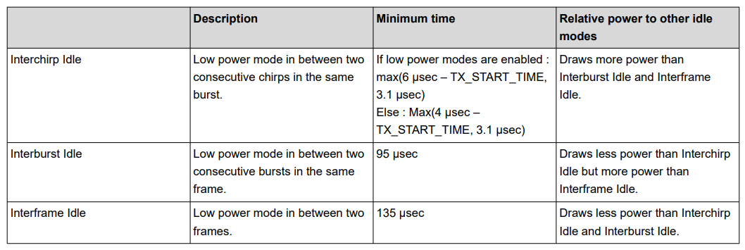

    What idle time are you referring to here or are you asking how its decided when we enter each idle state? The following table from the app note may answer your questions indirectly:
    The interburst idle power consumption is 115.01 mW.

    The power equations shared above is fundamentally how the Sensing Estimator calculates out the average power. To see the complete calculations, you can review the source code by importing the project from TI Gallery to GUI Composer.
