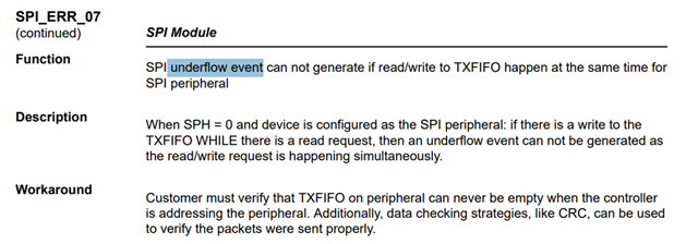

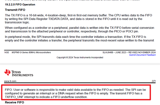

Hi Team,
My customer use M0G1506 as SPI slave, but he don't fill TX FIFO at first transfer. But M0G1507 receive wrong data(check by CRC) , why this happened?
In theory, slave can receive right data.
