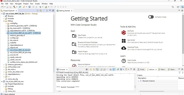

 i have imported the outof box demo example  project files from "C:\ti\radar_toolbox_2_30_00_12\source\ti\examples\Out_Of_Box_Demo\src\xwr6843ISK"  to CCS , done the follwing steps:
step 1:(not building  the project yetr)
i am not seeing any .bin file .xe files inside debug folder(attached screenshot for reference)
step2:(post building  the DSS project)
i could see  the following files(attached screenshot for reference)

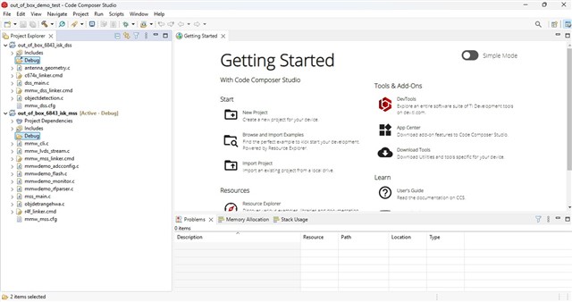

step3:(post building  the MSS project)
i could see  the following files inside debug folder of MSS(attached screenshot for reference)
   1.out_of_box_6843_isk.bin file
   2.out_of_box_6843_isk_mss.xer4f file

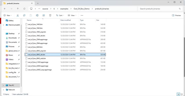

my requirement is to get single bin file (like available part of prebuilt binaries folder"C:\ti\radar_toolbox_2_30_00_12\source\ti\examples\Out_Of_Box_Demo\prebuilt_binaries"(screenshot attached for reference) ) to flash  the application into AWR6843ISK and check.

  • Hi Mani,
    Thank you for reaching out. (1)  To generate a single bin file in CCS you will need to use the ImageCreator in the post build phase. You can find examples of this in the [RTB]\source\ti\examples\Automotive_InCabin_Security_and_Safety\AWR6843_CPD_with_Classification\src\68xx\occupancy_detection_3d_68xx_mss.projectspec file. Observe the following:
    postBuildStep="rm -f ${PROJECT_ROOT}/occupancy_detection_3d_68xx.bin;
            ${COM_TI_MMWAVE_SDK_INSTALL_DIR}/packages/scripts/ImageCreator/out2rprc/out2rprc.exe ${ProjName}.xer4f ${ProjName}.tmp;
            ${COM_TI_MMWAVE_SDK_INSTALL_DIR}/packages/scripts/ImageCreator/multicore_image_generator/MulticoreImageGen.exe LE 37 0x00000006 occupancy_detection_3d_68xx.bin 0x35510000 ${ProjName}.tmp 0xb5510000 ${COM_TI_MMWAVE_SDK_INSTALL_DIR}/firmware/radarss/xwr6xxx_radarss_rprc.bin 0xd5510000 ${WORKSPACE_LOC}/occupancy_detection_3d_68xx_dss/${ConfigName}/occupancy_detection_3d_68xx_dss.bin;
            ${COM_TI_MMWAVE_SDK_INSTALL_DIR}/packages/scripts/ImageCreator/crc_multicore_image/crc_multicore_image.exe occupancy_detection_3d_68xx.bin occupancy_detection_3d_68xx.tmp;
            ${COM_TI_MMWAVE_SDK_INSTALL_DIR}/packages/scripts/ImageCreator/append_bin_crc/gen_bincrc32.exe occupancy_detection_3d_68xx.bin;"
    (2) CCS can generate this single bin file when you specify it in the projectspec.
    (3) The out_of_box_6843_isk.bin is the top level file which will contain the contents of out_of_box_6843_isk._mss.bin so they are different in the sense that the out_of_box_6843_isk.bin contains the combined two images for the dss and mss.
    Vignesh K.
