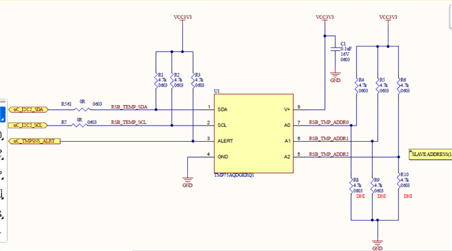

I am using this circuit in my design, all the design calculations are ok?,
Hello Meghna,
Overall the schematic looks good. I would recommend to replace the resistors on the A0,A1,and A2 pin with 0 Ohms.
Meredith McKean
Hello Meghna,
A direct connection to GND or VDD will be recognized by the device more easily when there is no resistance added to the address pins.
