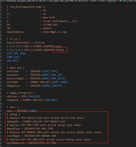

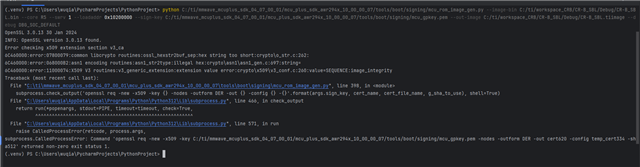

I want to use cansbl demo in my project,and I try to use the demo C:\ti\mmwave_mcuplus_sdk_04_07_00_01\mcu_plus_sdk_awr294x_10_00_00_07\examples\drivers\boot\sbl_can_uniflash,there is some problem:
1、When I build this project,there is something wrong in process of sign,and I modify the g_openssl3_x509_template of script mcu_rom_image_gen.py,remove extra extensions keeping only the `swrev` & `debug` extensions,I build project successfully.But is it modification correct?

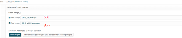

2、I use uniflash instead of python to flash SBL and app image,but when I start the board in QSPI mode,sbl and appimage does't startup,there is nothing capture from the uart,is it caused by question1?or anything else?

    Also can you build it using the makefile and ensure you have the right openssl version as per the user guide?
    We have tried building it and dont face any issues where you need to change any of the signing script.
