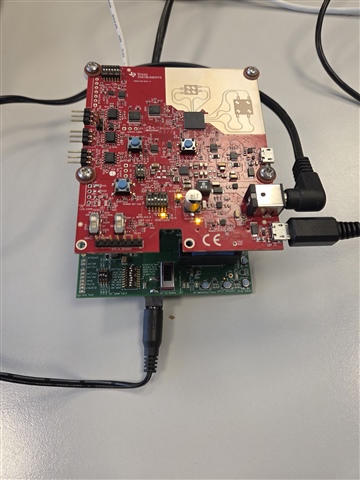

I am trying to acquire raw ADC data from the combo IWRL6844EVM + DCA1000 in mmWave Studio 4.3.1.0.
For that, I took carefully all the steps as described in User's Guide for mmWaveStudio 4.3.1, more specifically
1) updated the DCA1000 FPGA binary with the latest one from C:\ti\mmwave_studio_04_03_01_00\mmWaveStudio\PlatformBinaries\DCA1000FPGA\DCA1000_FPGA_RECORD_V2.9_21JUL2022.bit
2) set the switches as shown in Figs. 2-31 and 2-32 in EVM User's Guide: AWRL6844EVM IWRL6844EVM (swru636)
3) sorted out the connections and COM ports
4) configured the Ethernet connection so that 192.168.33.30 pings well
Then I arrive at the connected status in mmWave Studio as shown in the screenshot below without any No. Device Detected...
All the further steps I try in SensorConfig to acquire raw data fail. Could you help me out by resolving this issue?

  • HI, there:
    Is your DCA1000 powered?
    Can you send me the result in output window?
    Zigang
  • Hi Zigang,
    it was powered by an external adapter 5V / 3A and the EVM by 5V / 1.5A.
    The picture was included to show the switches, I took it with external power OFF and disconnected Ethernet while the EVM with LEDs ON was still connected via USB.
    By the way I am still not sure if the setup should be configured for 2 lanes ADC or 4 lanes?
    Let me come back with other info in a few weeks after my holiday.
    Thanks!
    Tim
  • Hi, Tim:
    Glad you mentioned, the EVM does not need a power supply, it is powered by USB port.
    Zigang
  • Hi Zigang,
    I reproduced the setup without a power supply for the EVM, please see the output results in the screenshots below.
    Apparently there are errors in red starting at 14:50:08. Thanks for helping!
    Tim
