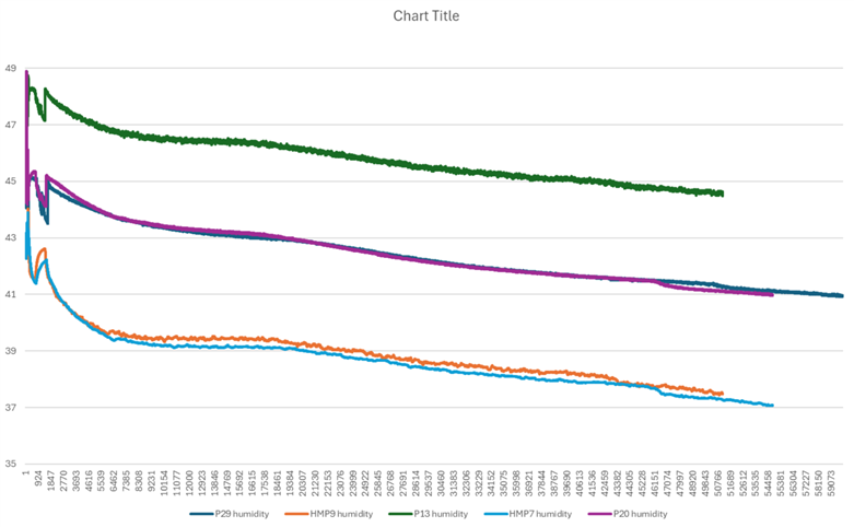

We are experiencing an offset issue in the humidity measured by HDC3022DEJR.
We have been using HDC3022DEJR to measure the humidity and temperature of flowing air at flow rates between 1-10 liters per minute. Out of 31 samples that we've tested, 22 fell within ±2.5% of the humidity reported by set of two calibrated reference sensors. The nine unfortunately were off but varying degree, with some samples by as much as 14%. All of our samples tend to report elevated humidities in comparison to our reference sensors.
Below are two images from a test where we compared three samples to a set of two reference sensors.
Above is a graph representing humidity data from during the test.

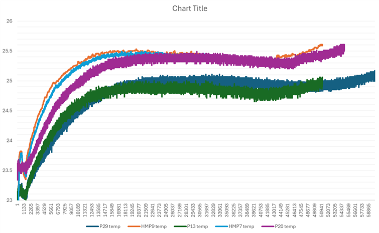

Above is the recorded temperature data during the same test.

  • Hi Tuomas,
    I want to ask you a few questions to better understand the nature of your issue.
    1. Can you share some details about the storage? Were these parts taken straight from a reel to PCBA then testing? Were they stored for any length of time in between those steps? If so, in what temperature and humidity conditions? Were they stored in bags, and if so, what kind? LDPE material, or metallized ESD bags?
    2. Do you have the lot information or NIST IDs for these parts? I can check internally to make sure they looked OK during our production test.
    3. I see that this data appears to be about ~40%RH for the test condition, were any other RH levels evaluated? If so, do you see the same RH error at every humidity level checked, or does it change?
    4. Was no-clean solder paste used during the PCBA, and was any board cleaner used? If so, could you share the MSDS so that I may evaluate if any chemicals that can cause contaminations (which will affect RH accuracy) are present?
    In the HDC3022 datasheet, baking is also mentioned as the first step for errors like this, then follow that with the 5 day soaking period. Was the bake attempted? If so, did it help the RH results at all?
    -Alex Thompson

  • Tuomas,
    Thank you, please share all the details when you have them. Polymer-based humidity sensors can have their RH accuracy shifted by a variety of things, so tracing down root cause is always a little tricky. Given that about two thirds of the parts are working well for you, I doubt the issue is rooted in your testing methods or PCB design. Can you think of anything these failing devices were exposed to that the good parts were not? UV light? Unique chemical exposures?
