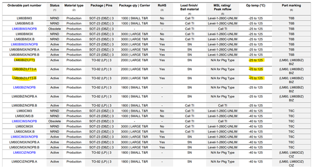

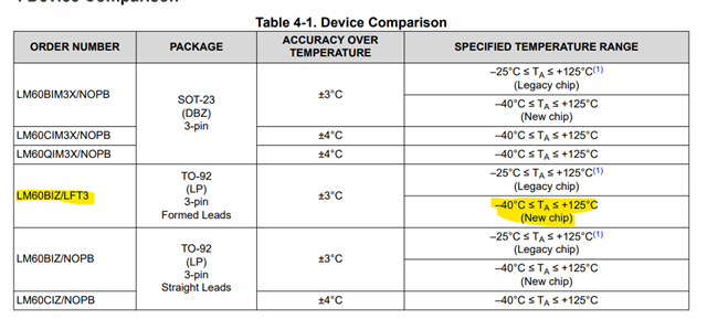

We are trying to order LM60 formed leads option with a temperature range of -40°C to +125°C.
I see the option here in this table.
But the ordering info table doesn't show this option.
Could you please let me know how to order formed leads version with the range -40 to +125°C (new chip)
  • Hi Shamanth,
    The new silicon version of the LM60BIZ/LFT3 is not a separate orderable from the old silicon version. The stock of existing material will be depleted first and then the new die will be made and shipped out. As of this time, I don't know when that will be.
    -Alex Thompson
