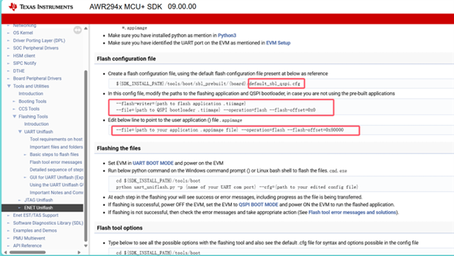

We are trying to use ENET interface to communicate with AWR2944EVM. Now following the doc "AWR294x MCU+ SDK: SBL QSPI ENET (C:/ti/mmwave_mcuplus_sdk_04_04_01_02/mcu_plus_sdk_awr294x_09_00_00_15/docs/api_guide_awr294x/EXAMPLES_DRIVERS_SBL_QSPI_ENET.html)", and then performing the Example "ENET Uniflash". In the example, the code "sbl_qspi_ene" needs to be flashed into ARW2944EVM  according to the userguide ("C:/ti/mmwave_mcuplus_sdk_04_04_01_02/mcu_plus_sdk_awr294x_09_00_00_15/docs/api_guide_awr294x/TOOLS_FLASH.html"). Following this userguide, the three file paths are requied to be added to the cfg file "default_sbl_qspi.cfg" . We have added these three file paths in below:
"C:\ti\mmwave_mcuplus_sdk_04_04_01_02\mcu_plus_sdk_awr294x_09_00_00_15\tools\boot\sbl_prebuilt\awr294x-evm\sbl_uart_uniflash.release.tiimage",
"C:\ti\mmwave_mcuplus_sdk_04_04_01_02\mcu_plus_sdk_awr294x_09_00_00_15\tools\boot\sbl_prebuilt\awr294x-evm\sbl_qspi_enet.release.tiimage"
"C:\ti\mmwave_mcuplus_sdk_04_04_01_02\mmwave_mcuplus_sdk_04_04_01_02\ti\demo\awr294x\mmw\awr2944_mmw_demoTDMEnet.appimage".

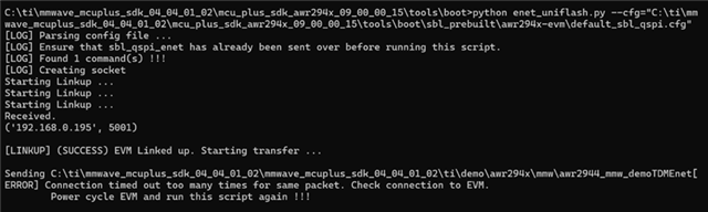

After that, we run "enet_uniflash.py",  there is something wrong, and the link failed.

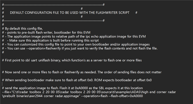

    The content of my default_sbl_qspi.cfg configuration file is as follows:

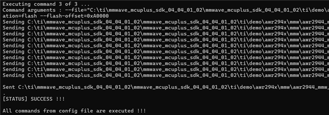

    The complete log from the command line terminal is as follows:

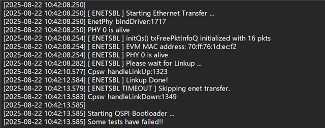

    The complete log from Tera Term is as follows:

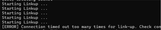

    Logs indicate that the link is successfully established ([LINKUP] (SUCCESS)), but a timeout occurs during the data transmission phase, and the EVM consistently displays "[ ENETSBL TIMEOUT ]". I would appreciate your assistance with the following questions:
    1. What could be the potential causes of this issue (e.g., network configuration, SBL parameters, image compatibility)?
    2. Are there any additional configuration requirements for Ethernet flashing of larger images such as radar demos?
