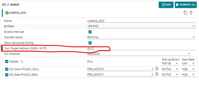

I am working with the IWRL6432 device and need to interface it over I²C. However, I am unable to find the I²C slave address in the datasheet or technical reference manual.
Could you please confirm the correct I²C address for this IC, or point me to the relevant documentation where it is specified?
Thanks in advance for your support.
Fenil
  • Hello Fenil.
    The I2C address is set in the SysConfig file.  I've included a screenshot below on where to find it in the Sysconfig file of your project.  You can find more information on the I2C driver in the SDK documentation(<MMWAVE-L-SDK-INSTALL-PATH>/README_FIRST_xWRL6432.html).
