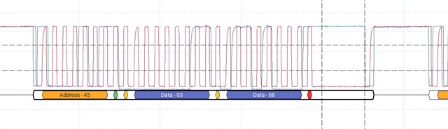

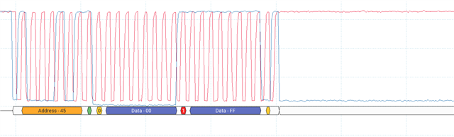

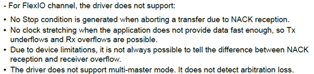

When we were debugging the I2C data of the OPT4001, since our I2C was simulated by Flex io, in the test results, it was found that when reading the data of the OPT4001, the MCU occasionally failed to generate the Stop signal normally, which would drag down the SDA bus time by up to 100ms, causing bus data errors. Are there any special requirements for the I2C opt4001, such as the main unit needing to have the Stretch function, etc., or do you have any experience to share in this regard
