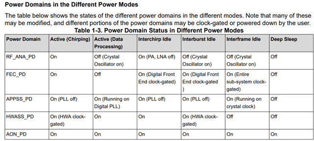

Hello Team,
When TX1 transmits in TDM modulation, is amplifier of TX2 OFF?
When TX2 transmits in TDM modulation, is amplifier of TX1 OFF?
When both TXs don't transmit, are amplifiers of both TXs OFF?
Yuichi
Hi Yuichi,
You can refer to the section 1 " Power Domains in the Different Power Modes" of the below app note. The PA and LNA are turned off during the inter-chirp idle time. So, the Power Amplifier for the TX2 is Off when TX1 transmits and vice versa.
Ankit
