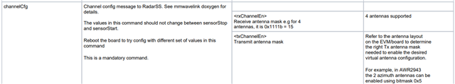

I am trying to change settings in a configuration file to download to the 2544 EVM.  I have a configuration file that was sent by TI that loads correctly and I can get the raw data in a '.bin' file.  However when I change the profile config and/or the channelcfg I cannot get the the raw data.
I've been searching through the documentation for clear details of the argument settings but I have had no luck.  The best source I've used is a MatLab example that parses the data.  I was able to read my config file into that and it will produce the correct radarParam(the structure in MatLab).
I'm attaching the original Ti file and my modified file.  Initially I am just trying to change the Tx/Rx antennas, the bandwidth, start frequency.  I'm using the default parameters in mmWaveStudio as a reference.  I will attach screenshots of those as well.

    If you want details on each argument and their parameter I would refer to the SDK user guide at this path.
    file:///C:/ti/mmwave_mcuplus_sdk_04_07_01_03/mmwave_mcuplus_sdk_04_07_01_03/docs/mmwave_mcuplus_sdk_user_guide.pdf
     Here is an example screenshot showing parameter info

    If I understand correctly you were able to collect adc data with the original config, but once you changed certain config parameters ( Tx/Rx antennas, the bandwidth, start frequency) you were no longer able to collect data.
    This is not a data collection issue, this an issue with the board. Most likely these changes are causing an error or assert in the SDK OOB code as in it is not an accepted configuration.
    So, if you require these config changes I recommended doing everything via studio to verify that these changes will work. When working with studio the board is in development mode so nothing flashed will affect the config. You are essentially providing all the firmware and the configuration. IF you're not familiar with the process of connecting to the board, loading the firmware, configuring the board, and capturing data on studio then please refer to this document in studio. Start at section 6 and it will spell out the steps to do.
    mmwave_studio_user_guide.pdf
    If the config is not accepted with the OOB SDK project then there is nothing you can do. There are programmed safeguards in the OOB demo to ensure functionality with only certain confiigs and I do foresee changing the starting frequency, etc. will be an issue. Please try this with studio first.
