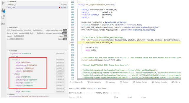

  • Hi Vignesh,
    I have an additional information: I set the value of 'gUseArtificalPointCloud' to 1, and data of type 1020 can be seen on the monitored data serial port.
  • Hi Jia,
    Thanks for this information. I am still investigating for a possible solution here and may need some more time.
    Vignesh K.
  • Hi Vignesh,
    I'd like to share my debugging progress with you for your reference: I disabled IPC, manually controlled task scheduling in debug mode, and found that I can monitor the point cloud data.
    I hope we can resolve the issue as soon as possible. Thank you!
    JiaPing

  • Hi Vignesh,
    Thanks for your questions! I suspect that FREERTOS or IPC have issues, so I have made the following changes:
    Engineering Changes
    1. After mmwDemo_dspConfig() completes, I added a while (flag) {} loop to control the flow.
    2. For the DSS (Digital Signal Subsystem), instead of using the original task mechanism, I directly call demo_in_cabin_sensing_6844_dss(). Also, I removed some WAIT_FOREVER settings (especially where debugging couldn’t proceed).
    3. In demo_in_cabin_sensing_6844_dss(), I added debug code as follows:
      uint8_t uctest_flag = 1;
      uint8_t  uctestmode = 0;
      /* Handles events from the queue and processes the FSM  */
      while (uctest_flag)
         if(uctestmode==1)
             DPC_DSS_ObjectDetection_PreStartCfg preStartCfg;
             DPIF_MSS_DSS_PreStartCfg *dpifPreStartCfg = (DPIF_MSS_DSS_PreStartCfg *)0x88087930;
             mmwave_parseInputConfiguration(&preStartCfg, dpifPreStartCfg);
             errorCode = DPC_ObjDetDSP_preStartConfig(&preStartCfg);
             uctestmode = 0;
         if(uctestmode==2)
             DPC_ObjectDetection_execute();
             MsgIpc_sendMessage(&gMmwDssMCB.msgIpcCtrlObj, DPC_DSS_TO_MSS_POINT_CLOUD_READY, (uint32_t) gMmwDssMCB.outputFromDSP);
             gMmwDssMCB.interSubFrameProcToken--;
             gMmwDssMCB.radarCubeReadyEventCntr++;
             uctestmode = 0;
      Here, uctestmode == 1 is used to configure antenna geometry, and uctestmode == 2 is for calculating point clouds.
    Step-by-Step Operation
    1. After receiving a CLI (Command Line Interface) command, pause the MSS (Microcontroller Subsystem) once mmwDemo_dspConfig() finishes running.
    2. Run the DSS core and modify the local variable uctestmode = 1.
    3. Run the MSS core, and pause the MSS when executing in DPC_Execute() until reaching the line /* Send to DSP message that the radar cube is ready */.
    4. Finally, run the DSS again, set uctestmode = 2, and then monitor global variables to view the point cloud data.
    Point Cloud Data Status
    Regarding your second question, the point cloud data I observed are valid values (not garbage data).
    JiaPing

  • Hi Jia,
    We found the culprit of the issue. Please make the change outlined below in the mmw_cli.c file:
    static int32_t CLI_MMWaveCompRangeBiasAndRxChanPhaseCfg (int32_t argc, char* argv[])
    #if LOC_VAR_OUSIDE == 0
        DPU_Doa3dProc_compRxChannelBiasCfg   cfg;
        int32_t argInd;
        int32_t i;
        float absMax, absMaxInverse;
        float absVal;
    #endif
        float *phaseCompVect = gMmwMssMCB.dspPreStartCfgLocal.phaseCompVect; //For SBR/CPD cfg
        gRxCompCfgCntr++;
        while (gRxCompCfgCntr == 2)
        /* Sanity Check: Minimum argument check */
        if (argc != (1+1+SYS_COMMON_NUM_TX_ANTENNAS*SYS_COMMON_NUM_RX_CHANNEL*2))
            CLI_write ("Error: Invalid usage of the CLI command\n");
            return -1;
        /* Initialize configuration: */
        memset ((void *)&cfg, 0, sizeof(cfg));
        /* Populate configuration: */
        cfg.rangeBias          = (float) atof (argv[1]);
        argInd = 2;
        absMax = -FLT_MAX;
        for (i=0; i < 2*SYS_COMMON_NUM_TX_ANTENNAS*SYS_COMMON_NUM_RX_CHANNEL; i++)
            absVal = fabs(atof(argv[argInd++]));
            if (absVal > absMax)
                absMax = absVal;
    This change should fix the issue. The issue of no point clouds being outputted occurs due to a calculation error which happens when absMax is not initialized. This issue only occurs on IWRL devices as the RAM is not initialized like it is on AWRL devices.
    Please let me know if this change works. Additionally, this fix will be rolled out in our next radar toolbox release.
    Vignesh K.
  • Hi Vignesh,
    Good news—your fix works!  Thank you very much!
    JiaPing
