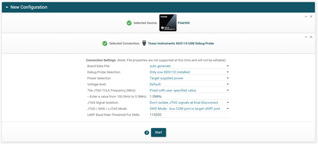

    1. Connect the debugger to the user's computer. Launch Uniflash, go to "New Configuration" and select the following settings.
      1. If using the PGA970, select PGA970 as the selected device. All other settings remain the same.

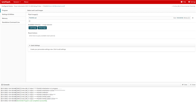

    2. Power the PGA and connect the debugger. The PGA device must be running in order to flash firmware.
    3. Select "Start"
    4. Select "Load Image"
    5. Disconnect the debugger and being using the PGA device as desired

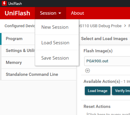

    The user can save their session configuration settings.
