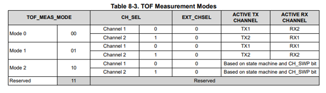

Can i add an analog switch CD74HCT4066-Q1 in between TX1 and RX2 to do signal path open and close control ?
Or do you have any other suggestion ?

In mode 0, the device is already switching between TX1 and RX2.
If you wanted to control the switching, you could do this externally, but you probably would want a switch with a lower Ron specification. You can find low Ron switches below.
