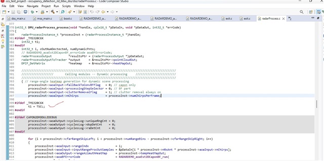

  we are using AWR6843ISk + mmwave booseter setup . and able to run the "AWR6843_CPD_with_Classification"  example  project  on  debug mode on code composure studio .
i see part of the code there is logic to estimate time taken for the logic to execute,(screenshot attached for reference)
my question:
 1.where i can find the estimated time value "processInst->benchmarkPtr->buffer[processInst->benchmarkPtr->bufferIdx].dynHeatmpGenCycles"?
    if its get stored in this variable then how to get this value to visulaise?

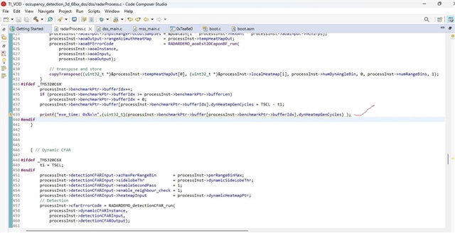

      1.   i run the example with AWR6843ISK +mmwavebooster in CCS debugger.I just added one printf statement to the existing code to diplay the code estimated time. But console is not printing any result. Screenshot are  attached for your reference.
    screenshot1(printf statement added to existing code)
    screenshot2(console is not printing the value )

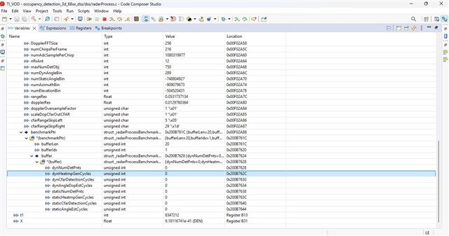

    2.  As you suggested  "to  read the value through the Variable window of the CCS debugger" ,i have kept a breakpoint as shown in below screenshot3 but it throws the error and stop the execution of code(screenshot 4 attached)
    screenshot3(executed with breakpoint as added  ):
    screenshot4(variable window from ccs debugger after breakpoint  ):
    please check and provide the solution to visualize/print the code estimation time.

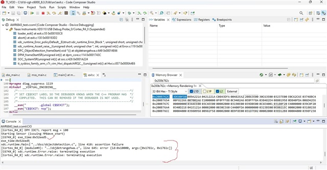

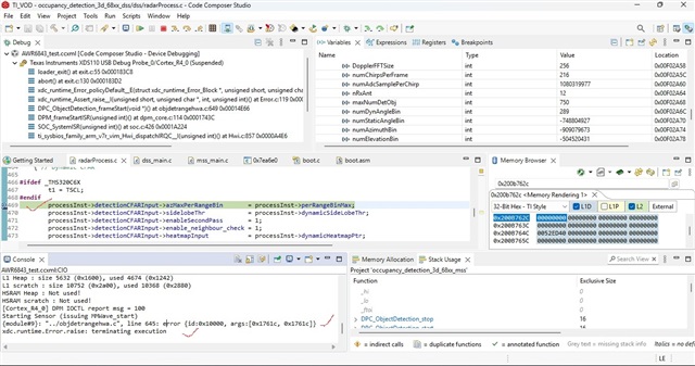

    You can use the System_printf function instead of the printf function to print directly to the debug console if you are using the MMWAVEICBOOST.
    Kristien
  • hi kristien,
     thanks for your reply.
    As you suggested, i used system_printf instead of printf statement, It prints the value but terminate further execution of code(screenshot is attached for your reference).
    how to fix the issue of code termination issue and also print the execution time ?
    regards,
    Mani
  • Hey Mani,
    Are you resetting both the R4F and C674 cores before loading the individual .out files for each core? I would also recommend grouping the cores as mentioned in the CCS Debug User Guide from the Radar Toolbox so that you can start both programs at the same time. The program should execute, even if the two cores are started at different times, as long as they're both running prior to sending a configuration. Failing to run the DSP core and code could be causing this issue.
    Kristien
