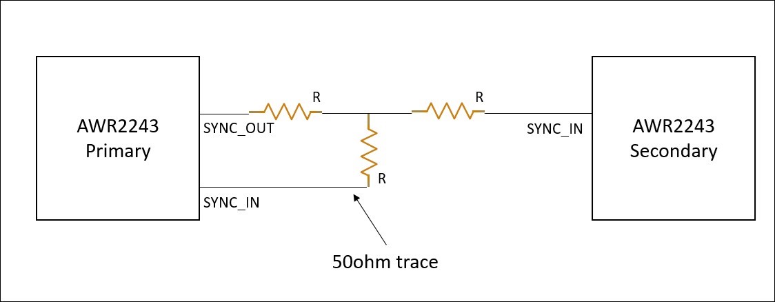

 In TI's reference design on https://www.ti.com/tool/AWR2243-2X-CAS-EVM, due to we can't find the automotive grade Q100 certified clock buffer (PS: the reference design uses "LM686x0-Q1 70V, 8A/6A/4A, Automotive Buck Converters Optimized for Safety-Relevant Applications datasheet" which is not automotive grade), we will like to use resistors as divider for sharing the 20GHz Sync signals as below picture.
 Is the connection of the Sync signals directly as below ok?
 if this connection is fine, please advise the value of “R” and layout guide TI suggested.
