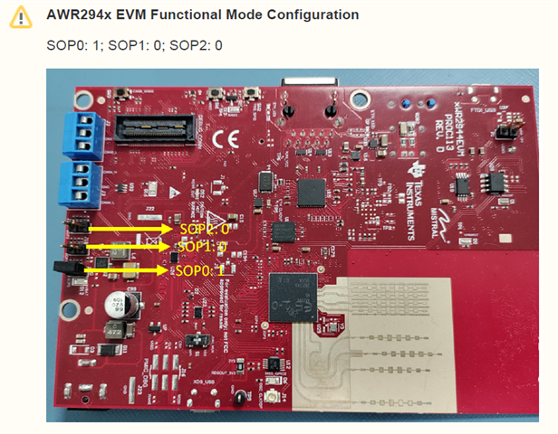

Problem:
  • When I try to debug/load the MSS binary (out_of_box_2944_mss.xer5f) in CCS, I get this error:
  •  (Error -2062 @ 0x0) when using SOP011 - development mode.
  • (Error -1065 @ 0x40) when using SOP101 - flashing mode.

  1. Which SOP mode should I be using for JTAG debug with CCS? (I currently tried 011 for development and 101 for flashing, but I still cannot load to memory).

  • Hi Mahmoud,
    You need to use Functional mode.
    Is there a specific load sequence required (MSS first, then DSS, then RadarSS) to avoid this memory access error?
    Firstly, you cannot connect to RadarSS (RSS or BSS). mmWavelink to used to configure the Radar Frontend. In the SDK demo, MSS communicates with RSS and configures the Radar Frontend.
    The issue that is you are facing is mainly due to the SOP mode that you are using. Can you try using functional mode?
    Should i re-enable IPC/RPMessage?
