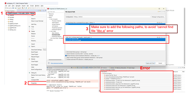

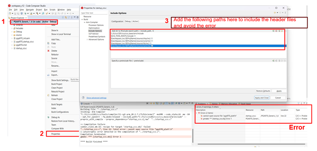

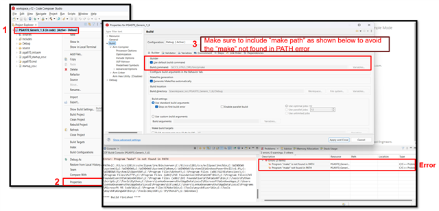

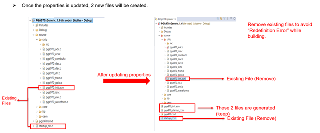

I am trying to build firmware in CCS for use with PGA900 or PGA970. I am running into errors while compiling my code. What is going wrong?
  • CCS v12.8 is TI's preferred version when writing firmware for PGA900 and PGA970. All the errors below are relevant to CCS v12.8.
    Here are some common issues:
    • You did not install the PGA feature set when you downloaded CCS
    • You did not copy rtsv6M0_T_le_eabi.lib into the following path: C:\ti\ccs1281\ccs\tools\compiler\ti-cgt-arm_20.2.7.LTS\lib

      • You need to delete some files after updating the properties
    • Your error is "Program "make" is not found in PATH"
    • Your error is "fatal error: cannot open source file "pga970_platf.h"
    • Your error is "unresolved symbols remain"
