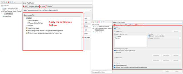

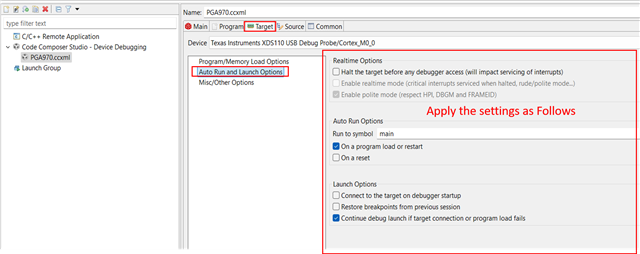

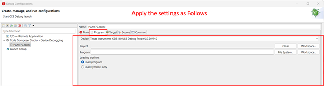

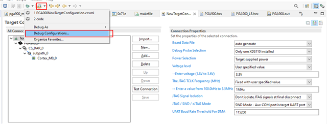

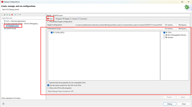

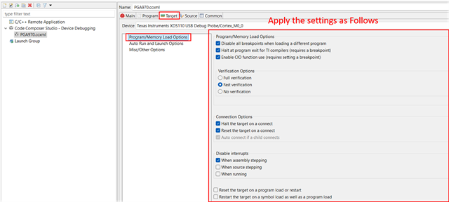

I have firmware I want to debug for PGA900 or PGA970? How do I setup my debug configuration in CCS?
  • These instructions apply to CCS v12.8 with an XDS110 debugger
    In order to debug PGA900/970, the microcontroller in the device must be running. By default, the microcontroller is running every time the device powers on.
    Step 1
    Step 2
    Step 3
    Step 4
    Step 5
    Step 6
    Step 7
