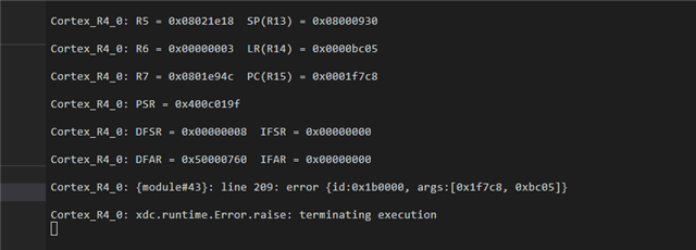

How can i modify these errors.
Cortex_R4_0: {module#43}: line 209: error {id:0x1b0000, args:[0x1f7c8, 0xbc05]}
Cortex_R4_0: xdc.runtime.Error.raise: terminating execution

  • Hello Eric,
    Under what condition are you getting this error? Is it from running a default program with no changes and a configuration with no changes?
    Pedrhom

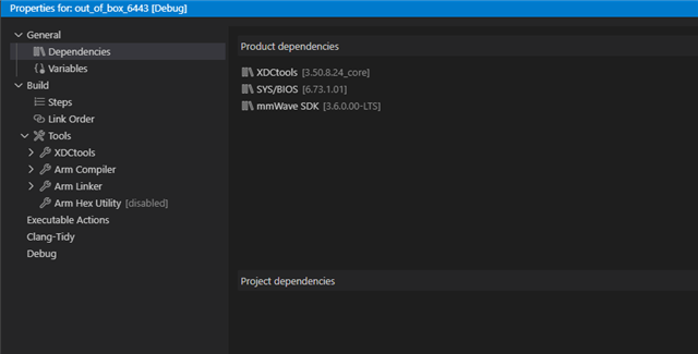

  • Hello Pedrhom,
    I did test just a demo application for IWR6843AOPEVM board, I didn't change any configuration and source code.
    Eric

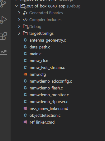

    What example project is being used here for your 6843AOP? And I am guessing this error you are getting after sending a configuration to the device? Which configuration?
    Pedrhom
  • Hello Pedrhom,

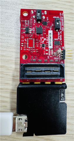

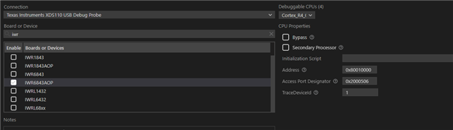

    Are you using the EVM with a MMWAVEICBOOST for debugging purposes? The IWR6843AOPEVM does NOT have a XDS110 debugger built into the EVM. Meaning you can still flash compiled .bin files from a release perspective, but not the individual .out/.xer4f/.xe674 files and thus cannot set breakpoints, explore memory, etc from a debug perspective. If you are using a MMWAVEICBOOST, when do you get this error exactly? Is it during sensor start up I imagine? Is this happening after the sending of a configuration file?
    Pedrhom
  • Hello Pedrhom,
    I have mmaveicboost. I did debug by iwr6843aopevm(Deprecated) installed on the mmwaveicboost.
    Eric.

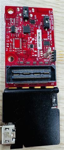

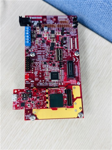

  • Hello Eric,
    Can you take a picture of the physical setup? If I see no issues then its possible the MMWAVEICBOOST is faulty. Please double check the two links below as well
    EVM Switches Modes
    Debugging with CCS 20
    Pedrhom
  • Hello Pedrhom,
    I'm using this setting.
    Eric.
  • Hello Pedhrom,
    Is it correct ?
    Do I need to modify which one?
    Eric.
  • Hello Eric,
    The problem is that you are using an obsolete EVM. I am genuinely very curious, how did you acquire a Rev. C 6843AOPEVM? It uses an older silicon revision and the software offerings we have in the toolbox and SDK will not support it. Our current and final revision is Rev G and looks the way seen below
    https://www.ti.com/tool/IWR6843AOPEVM
    You may be able to get a old version of the SDK to work with this EVM. I checked the release notes and the below SDK from six years ago is the last one that works with ES1.0
    https://www.ti.com/tool/download/MMWAVE-SDK/03.02.01.02
    Pedrhom

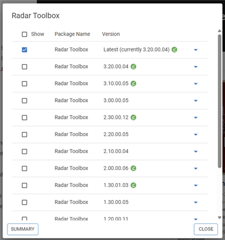

  • Hello Pedhrom,
    How can I download&install the Industrial Toolbox?
    Eric.

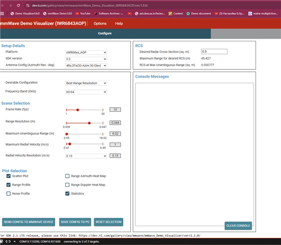

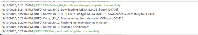

  • Hello Pedrhom,
    I did set to flash mode  and load the binary file from C:\Users\eeric\Downloads\radar_toolbox_3_20_00_04\radar_toolbox_3_20_00_04\source\ti\examples\Out_Of_Box_Demo\prebuilt_binaries
    In this Photo, IWR6843AOP didn't communicate with UI. How can I modify this problem?
    Which version is correct with this IWR6843AOP (Deprecated)?
    Eric.
