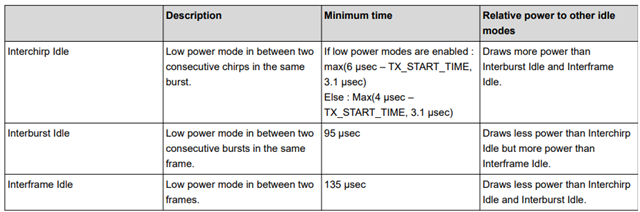

    I am attaching an image below which talks about various states of AWRL6432 from front end application perspective.
    As you can see from the above image, the FECSS is Clock gated only during Inter frame idle times.
    You can refer to the xWRL6432 Power Consumption application note for more details on minimum inter frame idle times required to turn off the FECSS clock etc.
    Kundan

  • Hi, SWRA754 is the application note for Low power mode implementation in xWRLx432 platform of devices (xWRL1432, xWRL6432, xWRL6432AOP)
    The minimum idle times are already captured in the application note.
    Please go through the application note and it is clearly mentioned how the FECSS power domain is configured in different modes of operation.
    Kundan

    The short idle time refers to both the interchirp idle state and interburst idle state, and the long frame idle time is the interframe idle state. As shown by the table Kundan shared, the minimum interchirp idle time is based on if low power mode is enabled, though worst case scenario, its 6 us. The minimum interburst idle is 95 us and minimum interframe idle time is 135 us. Therefore, the short idle time ranges from 6 us to 135 us. The long frame idle time spans 135 us to 2.1 ms; the maximum is determined based on the low power mode transition time needed.
