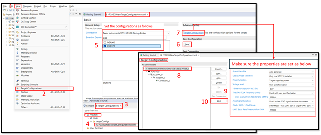

I am writing firmware for PGA900/970. I am trying to launch a debug session so I can debug my firmware. How do I launch the session properly?
  • These instructions apply to CCS v12.8 with an XDS110 debugger
    First, you must configure your Target Configuration file appropriately.
    Once you've connected the debugger to your hardware, you can use the "Test Connection" button to make sure everything is properly connected.

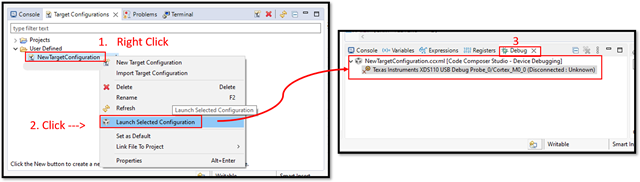

    Step 1. Launch the Target Configuration you just created.

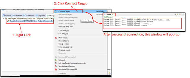

    Step 2. Connect to the Target

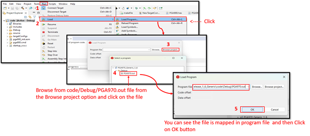

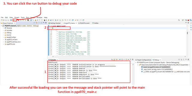

    Step 3. Load the binary file (.out) and begin debugging.
