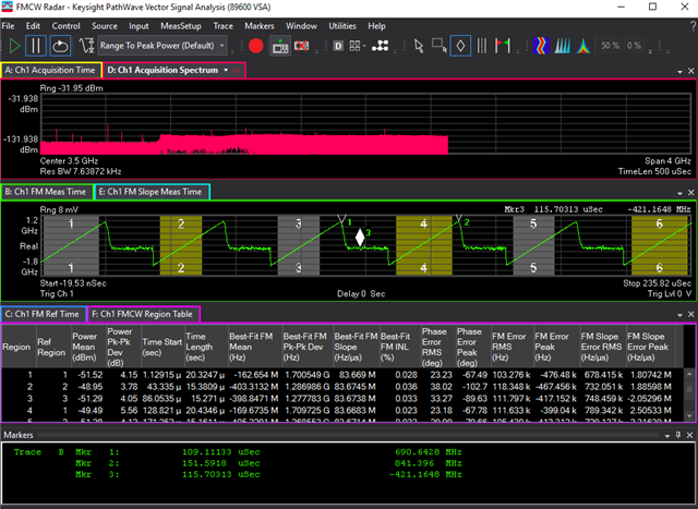

Now we are using AWR1843 chip to develop our radar .
We designed a kind of chirp and measured on the spectrum and oscilloscope.
The chirp parameter is listed as below:
Idle Time = 8us
Ramp End Time = 34.6us
slope = 83.7 MHz/us
StartFreq = 77.56GHz
Total sweep bandwidth = 2.89GHz
The bandwidth meausred on the spectrum looks right.
But on the  oscilloscope, the test results show that it is not a correct standard chirp.
The signal does not drop to the starting frequecny within the idle time.
Can you help us check if there is any problem?
The oscilloscope is Keysight DSOS404A , and the chirp analysis software is Keysight 89600 VSA
