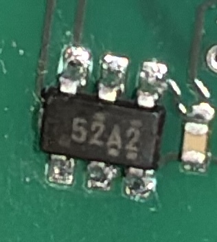

  • Do happen to know the REV of the TMAG5273A2 device that you are currently working with? It should be listed on the label of the bag/box that it came in (if you still have it).
    No, it doesn't appear so. We're using these chips on PCBs we had built, and the company that built the PCBs bought the parts.

    Could you share an image of the date code on top of the device package?
    ~Alicia
  • Hi Steve,
    Thank you for the image of the device. I plan on using it to determine when the device was made to see if we can pinpoint why the command byte isn't what it is expected to be for the A2 variant.
    ~Alicia
