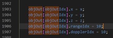

The reason for this addition is that later on in the processing pipeline we want to collect doppler data around each detected point and send it over ethernet. My question is then: where in the code are the x, y, z and velocity values being set? I have located some possible places and placed dummy values, such as on row 1903 in aoaprochwa.c:
    objOut[objOutIdx].x = x;
    objOut[objOutIdx].y = y;
    objOut[objOutIdx].z = z;
    objOut[objOutIdx].velocity = params->dopplerStep * (float)dopplerIdx;
    objOut[objOutIdx].rangeIdx = 10; /* DUMMY VALUE SET HERE */
    objOut[objOutIdx].dopplerIdx = 10; /* DUMMY VALUE SET HERE */

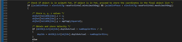

    Could you try doing this in objectdetection_elevEst.c in the DPC_ObjDet_estimateXYZ() function. I will attach a screenshot of the code with the line numbers.
    Gabriel
  • Hey Gabriel,
    I have modified the code inside objectdetection_elevEst.c with the following:
    if ((azimSinPhase > subframeCfg->aoaFovSinVal.minAzimuthDeg) && (azimSinPhase < subframeCfg->aoaFovSinVal.maxAzimuthDeg))
        /* Store x, y, z values */
        objOut[ValidObjIdx].z = z;
        objOut[ValidObjIdx].x = x;
        objOut[ValidObjIdx].y = (float)sqrt(ySquared);
        objOut[ValidObjIdx].dopplerIdx = 10; /* DUMMY VALUE */
        objOut[ValidObjIdx].rangeIdx = 10; /* DUMMY VALUE */
        /* Obtain and store Velocity */
        if (detObjList[objIdx].dopIdxActual > numDopplerBins / 2U)
    but I still see random/garbage values in the output for rangeIdx and dopplerIdx:

    I was able to print the correct dummy values and will share my steps on how to do so. Here is my console output
    1) Add the appropriate definitions for rangeIdx and dopplerIdx in the DPIF_PointCloudCartesian_t struct in dpif_point.h at the following path
    C:\ti\mmwave_mcuplus_sdk_04_07_01_03\mmwave_mcuplus_sdk_04_07_01_03\ti\datapath\dpif\dpif_pointcloud.h
    2)In AoAProcHWA_XYZestimation() in aoaprochwa.c add code like this
    3) This step is important because I believe this is what you missed. You must then built this library again. Navigate to the following makefile and rebuild the library
    C:\ti\mmwave_mcuplus_sdk_04_07_01_03\mmwave_mcuplus_sdk_04_07_01_03\ti\datapath\dpu\aoaproc\makefile
    4) You can print this info however you like but this is how I did. This code was added in mss_main.c in MmwDemo_transmitProcessedOutput().
    5) Then rebuild the entire TDM demo. You should see desired values
    Gabriel
