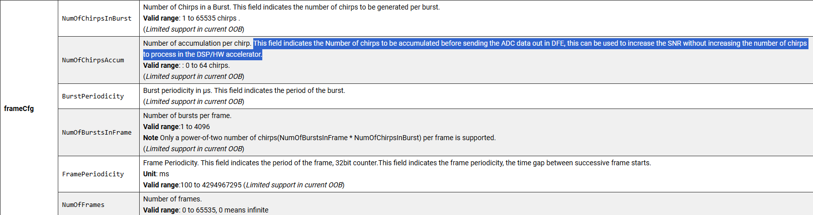

I would like to confirm whether increasing c_NumOfChirpsAccum leads to more chirps being transmitted as RF signals from the Tx antenna.
The manual includes the following description:
Section: Calculating Burst and Frame Period
Total Number of Chirps in a Burst = h_NumOfChirpsInBurst × max(1, c_NumOfChirpsAccum)
Does "Total Number of Chirps in a Burst" refer to the number of chirps transmitted as RF signals during the burst period?

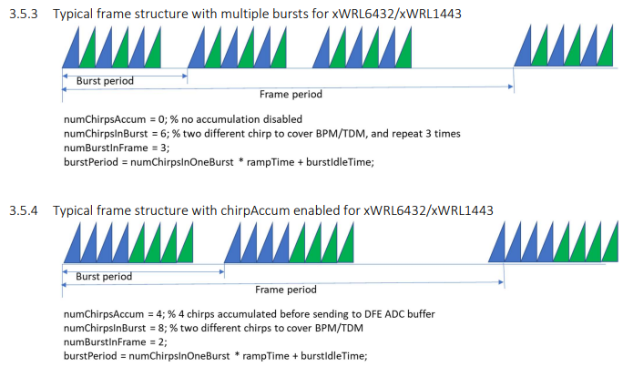

[Example]
If c_NumOfChirpsAccum = 4 and h_NumOfChirpsInBurst = 8,
then Total Number of Chirps in a Burst = 32.
Does this mean that 32 chirps are transmitted as RF signals during the burst period?

    A burst is just a series of chirps, and the number of chirps accumulated does NOT increase the number of chirps.

    I see the confusion here. The analog front end does physically emit more chirps, but then the extra chirps are accumulated and averaged before being passed onto the digital end that does the processing. The extra chirping provides a higher SNR without an increase in processing load. The DFP/firmware revolves around the antenna and analog portions of the radar sensor pipeline, while the SDK and example demos revolve around the cpu cores and digital portions of the radar sensor pipeline.

  • You are correct. The formula is for physical chirps emitted. To reiterate, that formula comes from the Interface Control Document, which is for the DFP and is a representation of the function calls for the analog front end.
    Later on, when looking at the software SDK which is for the digital ARM core and example demos, completely separate from the DFP, you may not see the mention of chirps accumulated because it is averaged out by design.
