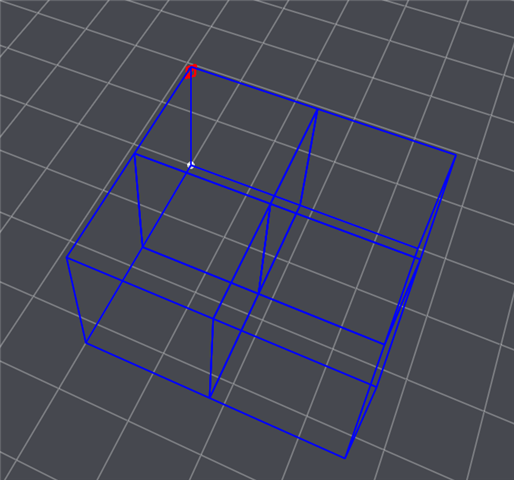

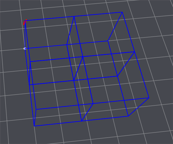

  • Default UI from the radar tool
Default GUI for the configured zone
UI while detecting occupancy

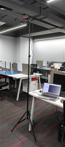

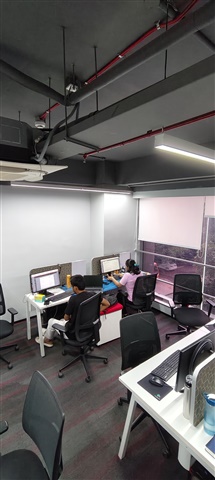

Test area image: Person sitting at farthest corner (zone 4)
The person sitting at farthest corner
Sensor placement image:

  • I am unable to achieve reliable occupancy detection in all 4 zones.
  • Specifically, Zone 4 (diagonally farthest from the sensor) never shows proper occupancy detection.
  • In the current test environment (~3.3 m × 3.6 m room), performance is already limited, and in the actual deployment target (~10 m × 10 m area), I am concerned about reduced efficiency.

    There is limitation about placing the box diagonally. You can use the appimage from the below location and attached configuration which will provide appropriate detection.
    radar_toolbox_3_10_00_05\source\ti\examples\Industrial_and_Personal_Electronics\Motion_and_Presence_Detection\Motion_and_Presence_Detection\prebuilt_binaries\motion_and_presence_3d\motion_and_presence_detection_demo_aop.Release.appimage
    You can use the MPD boxes as designed in the attached configuration
    mpd_boxes_redrawn.cfg
    You can use the same configuration for detection till 10m. You can extend the boxes for 10m usecase

    1. There is no restriction on placing the sensor at the corner of the room but software only supports rectangular boxes. If you need diagonal boxes, you will have to modify the software yourself
    2.If a person is making small movements, person will be detected. If the person is absolutely still, then there will not be any detection. Do note that breathing heavily also causes minor motion, so, it is totally scenario dependent. Sensitivity of detection is controlled by minorStateCfg
    3. For rangeSNRCompensation, you can refer radar_toolbox_3_10_00_05/source/ti/examples/Industrial_and_Personal_Electronics/Video_Doorbell/docs/Video_doorbell_users_guide.html
    Can you also try with the below appimage and configuration files?
    https://e2e.ti.com/cfs-file/__key/communityserver-discussions-components-files/1023/iwrl6432_5F00_aop_5F00_1725.appimage
    mpd_boxes_redrawn_v3.cfg
    mpd_boxes_redrawn_v4.cfg
