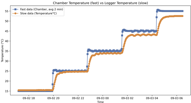

We have been testing the LM35 to see if it is suitable for our cold junction sensor on our thermocouple measurement system. With this sensor we have noticed a Drift over a temperature range from 15°C to 55°C.  Our oven has been calibrated recently. here is a graph of LM35 Error.
The -3.5°C temperature offset is expected because this LM35 sensor is in an electronics box that generating heat so we would expect the lm35 to be at a higher temperature than the oven. but we noticed that there is drift because the Offset changes as the oven temperature changes.

  • We see ~0.43C variation when the oven is holding temperature but we pick up this variation in the LM35. We ran one test with a calibrated witness thermometer, attaching a screenshot of the data. But the witness thermometer was not next to the oven temperature thermometer or next to the lm35.
    we will run a more controlled test in the next few days with a more controlled setup.

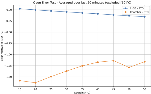

  • we ran the oven test with a RTD connected to a keysight digital multimeter as our temperature witness. On Our assembled prototype units we measured the LM35 output with a digital multimeter. We saw a little over 1C temperature drift.
    We had a lm35 witness connected to our rtd thermometer outside of our prototype unit and measured the output and we saw less than 0.2C drift.
    can you think of anything that could cause the LM35 drift to be out of spec?
  • Greg,
    Please assist me in understanding these two graphs.
    From what I understand, the first graph is showing two different assemblies with LM35 in blue and orange compared to an RTD which is the black line. And the temperature is being stepped up? So as temperature is increasing, the temperature error (y-axis) of the LM35s is getting more and more negative. Or is the chamber being held at one temperature, and the LM35s are drifting up in their temp result. But if that is the case, why is the RTD line going up and why are the LM35 lines having those negative spikes? Are those from something other than temp changes?
    For the 2nd graph, I see that temp is changing and the y-axis is temp error. But the LM35 compared to the RTD is changing less than 0.25C across temp, while the chamber is changing more dramatically. What this tells me is the source of the drift is the temperature chamber moving around, not the LM35 having a real drift problem.

  • for the first graph the Temperature is being stepped up in 5 degree increments then dwell for 2 hours. The black line is the RTD temperature. the orange and blue is the error between the RTD and the LM35 so (LM35 - RTD). As the temperature increases the LM35 has an increasing error compared to the RTD close to 1.2C.
    so yea on the second graph there is no real drift problem but this is just a lm35 and RTD on the same piece of metal.
    but in our system we have an LM35 assembled on a PCB and we are seeing drift that is out of the LM35 specification on the data sheet
  • Greg,
    Is that LM35 placed near any components that could rise or fall in temperature as they are turned on and used? the LM35 may be experiencing slight temperature fluctuations due to PCB effects from other components. But to me it seems that most of this drift is just from the chamber.
