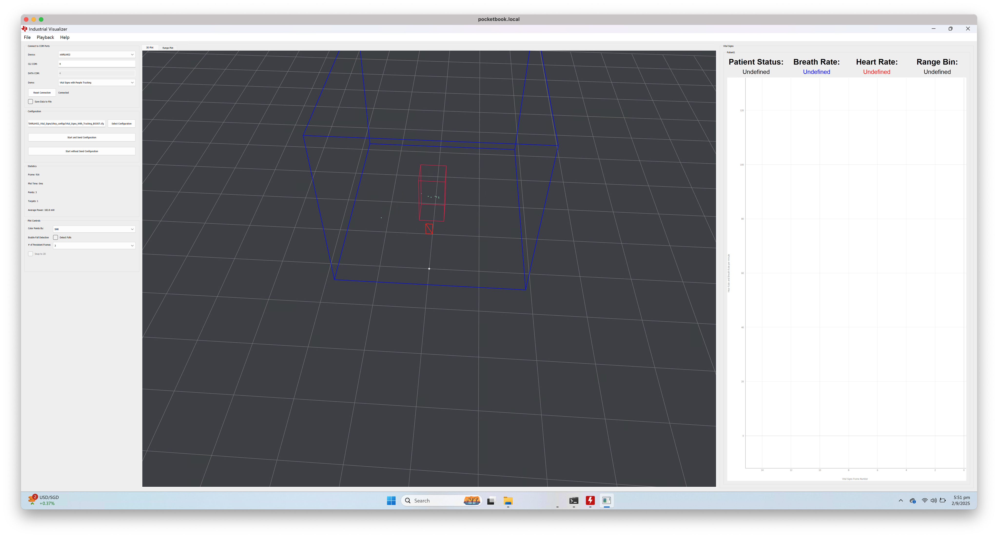

I am running the vital signs demo for IWRL6432BOOST. The patient status, breath rate, heart rate & range bin are always undefined, regardless how still and how long I sit in front of the EVM. I see point clouds & boxes in the 3D plot. Are there any specific requirements for this demo to work?

    Can you please send us the screenshot of the visualizer you are seeing?
    If you are able to see the point cloud and the box, it indicates you are being tracked correctly. The HR/BR should change from undefined to updating when you are being tracked
    Ideally, you should see the vitals updated in the visualizer after about 20 seconds from being tracked
    Which version of the radar tool box are you using?
  • Hi Abhishek,
    I am using the latest SDK (05.05.03.00) & toolbox (3.20.00.04).
    The issue is precisely that the HR/BR did not change from undefined after more than 20s of being still.
    Here's a screenshot of the visualizer.

  • The terminal occasionally also throws this error message:
    | Traceback (most recent call last):
    | File "gui_main.py", line 60, in <module>
    | sys.exit(app.exec_())
    | File "pyqtgraph\opengl\GLViewWidget.py", line 193, in paintGL
    | File "pyqtgraph\opengl\GLViewWidget.py", line 233, in drawItemTree
    | File "pyqtgraph\opengl\GLViewWidget.py", line 214, in drawItemTree
    | --- exception caught here ---
    | File "pyqtgraph\opengl\GLViewWidget.py", line 211, in drawItemTree
    | File "pyqtgraph\opengl\items\GLScatterPlotItem.py", line 142, in paint
    | ValueError: could not broadcast input array from shape (29) into shape (31)
    Error while drawing item <pyqtgraph.opengl.items.GLScatterPlotItem.GLScatterPlotItem(0x19a9fd68) at 0x12A09080>.
  • Hi
    Thanks for all the details.
    Visualizer in radar toolbox version radar_toolbox_3_20_00_04 has problems in displaying the vital statistics. We will fix it in the next version. Please use the below visualizer for IWR6843 vital signs
    radar_toolbox_1_30_01_03\tools\visualizers\Industrial_Visualizer\mmWave_Industrial_Visualizer.exe
