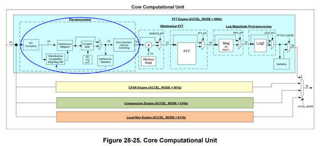

    My problem was in arguments of rangeProcCfg:
    rangeProcCfg 2 0 10 12
    I found that with your config (rangeProcCfg 2 0 300 300) in my environment detector returns fewer objects than in case of fast range processing option is disabled.
    To restore objects number I had increased thresholds (rangeProcCfg 2 0 500 500).
    Could you explain what magThresMinLim and magDiffThresMinLim actually mean?
    Are these absolute values like ADC samples magnitudes?
    How should I select these values?
    Dmitry
  • Hi Dmitry,
    HWA FFT engine has a pre-processing block which performs interference localization to identify samples corrupted by interference followed by interference mitigation to repair those samples. Any sample whose magnitude and/or magnitude of backward difference exceeds thresholds THRESH_MAG<n>
    and THRESH_MAGDIFF<n> is considered as affected by interference. In case of fast range processing option, Interference mitigation and interference estimation is performed in the same HWA paramset. In pre-processing stage of FFT engine, Interference Mitigation block comes first followed by Interference Statistics.
    Since we perform both Interference estimation and mitigation in the same paramset, so it might happen that thresholds get decrease below a certain level. In such a case, HWA may mark non-corrupted ADC data as interference affected and mitigate it as well. To avoid this, before loading into the HWA registers, processor ensures that magThreshold and magDiffThreshold are above intfMitigMagThresMinLim and intfMitigMagDiffThresMinLim respectively. Note: intfMitigMagThresMinLim is not used in the Range processing DPU currently.
    For better understanding of HWA and processing chain, refer to
    These minimum threshold limits can be defined based on your experiments.
