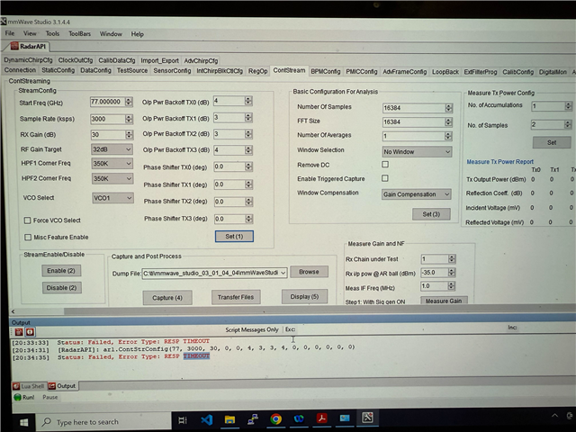

i have a set up with awr2544evm and dca1000. I’m able to use this setup with mmwavestudio with no issue. However, im trying to run this with continuous streaming mode (Contstream) but the hardware always timeout.
would you please let me know if i need to do anything in extra to have awr2544 run in ContStream mode?

    I think I know why I couldn't enable ContStream. Actually, some steps were missed. Here should be the right sequence: Connection --> StaticConfig --> DataConfig --> ContStream
    Following the above sequence. I'm able to enable ContStream mode now, but still getting one more issue regarding Basic Configuration For Analysis. I'm trying to change Number of samples and FFT Size to 1024, however getting indexing error: "Error: startIndex cannot be larger than length of string"

    Please let me know how to avoid this error.
    Thanks.
    This API does not work with DCA1000EVM. It is intended only for internal use, you must be connected to TSW1400 with HSDCPro running to use this API as it will also attempt to send the configuration details to the TSW1400 via HSDCPro. If you are not connected to TSW1400 you will see an error when issuing this API.
    Unfortunately, raw data capture in CW mode is not supported with DCA1000EVM. As a workaround you can do a capture in chirping mode with a zero slope chirp configuration.
