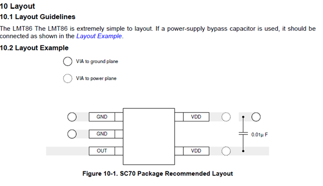

In LMT86 datasheet, there is a Layout Guidelines as following fig.
In my understanding, the optimal connection order from a low-noise perspective is: IC's VCC pin → decoupling capacitor → via → VCC layer.
However, your recommendation seems to reverse the order of the capacitor and the via.
Could you please clarify the reasoning behind this approach?
BR
  • Toshio,
    You are correct in your understanding, the bypass capacitor should be as close as possible to the LMT86 without vias in between. I think this layout drawing is misleading in that aspect. I am not sure how much a difference it will make but I would have the via to the power plane come after the bypass cap connects to the VDD pin, not before. I will look into if our team can update this drawing.
