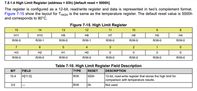

Hello Roger,
Yes, this is possible. I would recommend setting the high limit register to below room temperature. This can be done through I2C by writing to the high limit register 03h.
