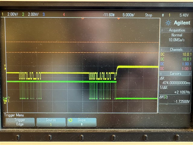

    Are you able to capture the OWI signals with an oscilloscope or a logic analyzer? In particular, could you capture PGA305 VDD and the OWI RX signal (I assume you have an external microcontroller reading the OWI signals)?
    Additionally, are you using a TI EVM? If not, can you please share a picture of your schematic?
    Maggie
    I am using PGA305EVM-034 with an external microcontroller
    Here's the scope shot of PGA305 VDD and OWI RX signal.

    OWI can be fussy in current mode. Since the OWI activation and TX levels have such narrow bounds, if you have too much current flowing through the loop, then your OWI signals may go outside of those bounds. That is probably why you are not able to communicate when you load the wrong coefficients.

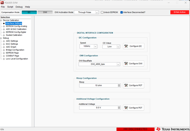

    In the PGA305 GUI, there is a way to adjust the OWI signal. Changing Additional Voltage will change the offset of the signal, and changing Rloop will change the amplitude of the signal.
    When you are unable to communicate with the device, can you try adjusting the OWI signals to re-establish communication? You will need to use an oscilloscope to read the voltages.
