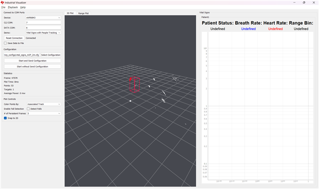

Hi
We are trying to configure and test IWR6843AOP and see the board's performance in Vital Sign and People Counting demo. But, Desktop Application never display patient status, breath and heart rate, range bin. Please see below image.
The board configuration is selected from C:\ti\radar_toolbox_3_20_00_04\source\ti\examples\Industrial_and_Personal_Electronics\Vital_Signs\Vital_Signs_With_People_Tracking\chirp_configs\vital_signs_AOP_2m.cfg
The prebuilt binary files are selected from:
C:\ti\radar_toolbox_3_20_00_04\source\ti\examples\Industrial_and_Personal_Electronics\Vital_Signs\Vital_Signs_With_People_Tracking\prebuilt_binaries\vital_signs_tracking_6843AOP_demo.bin
The visualizer is from C:\ti\radar_toolbox_3_20_00_04\tools\visualizers\Applications_Visualizer\Industrial_Visualizer\Industrial_Visualizer.exe
When the device is connected, error and warning raises:
ERROR [gui_core.py:769] Unable to reset the device. Check your xds reset path in <Industrial_Visualizer\misc\path.json>
INFO [gui_parser.py:289] Connected

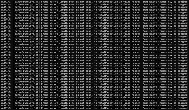

WARNING [parseFrame.py:148] Frame packet length read is not equal to totalPacketLen in frame header. Subsequent frames may be dropped.
